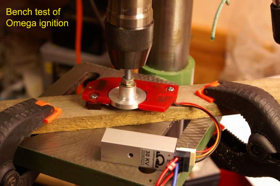

trolle
Re: Power loss at 4000 rpm?
« Reply #28 on: April 05, 2008, 09:48:59 AM »
The red thing in the picture is the ignition control unit and as you can see, there is a rotating aluminium disk with an embedded magnet (visible in the picture).
When this magnet passes a feeler placed in the ICU a red diode in the ICU lits up and stays lit for appr. 10 degrees of the disk's rotation. At first I had set the lighting of the diode to match the S mark on the flywheel but this was to early and therefore I changed the position of the alu disk to match the midpoint of the diodelight's period with the S mark.
I have not checked with my strobe light yet but when I checked the old setting, both the S (at idling) and the Z (above 3700 rpm) where sitting too low in the inspection hole.
greetings from a sunny, part cloudy north with good driving conditions
trolle
wiemer
« Reply #29 on: April 06, 2008, 03:48:29 AM »
OOhh,
That is not simple to adjust! So small, one touch and the ign moves a lot of degs. :o
When the ign marking is low in the hole, it is late. the crank turns clockwise, looking from front.
You should check with the strobe lamp the actual setting, which MIGHT please you more than the factury setting!
What we learned now is that a late ign aggravates the 4000 RPM power dip problem.
Let us know!
