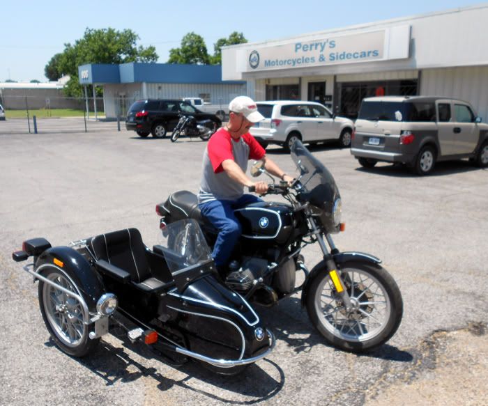

Former R65 forum member "Scotty in Texas" rolled his conventional forked R65 hack rig for many years throughout the Texas Hill Country without problems. His only issue with his R65 unit sidecar was a cracked mounting strut at one time.
Hooked up with Scotty at Perry's Motorcycles & Sidecars in Fort Worth on the day he swapped his R65 rig for an R90 -IIRC- rig that Perry was to build for him. More power. No Earles.
I will PM you his contact info. Contact Scotty with your questions and concerns. He's cool. Tell him I sent you.
