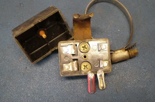

Checked the handlebar cluster and everything looked fine inside, but I noticed that the horn wouldn't work either.  Out comes the electrical schematic and I'm staring at it tracing all the wiring from the cluster.  What's that? Fuses? Oh yeah, fuses! I confess after all these years I never had to replace one. So first, where are the little buggers really?  Got out my handy little owners pamphlet and lo and behold, an actual picture of the fuse box on my bike.  Undid the screw retainer and pulled off the cover.  Oh look, a spare fuse...oh wait, that's not a spare, the damn thing fell out!  I squeezed the tabs a little tighter, checked the fuse and put it back in. Success!

A number of us have swapped out the old-style fuse box holder with newer, automotive style blade fuses, either in an aftermarket fuse panel or just using a couple of inline fuse assemblies available from your neighborhood NAPA/Autozone parts store.
I got tired of my flashers going out on me at various inopportune times (including immediately after getting the bike safety inspected and then trying to merge onto the roadway again).   As you have experienced, the old style fuze holders tend to lose their grip, or become oxidized, resulting in various system's going AWOL.   I replaced the thing with some crimp conenctors, heatshrink tubing and some watertight in line SAE mini-blade fuseholders from NAPA and haven't had a single failure since.

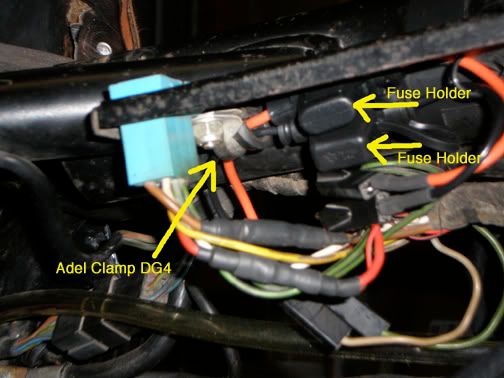

The plate is a scrap of automotive trim plastic from my box of "don't know what to do with but too good to through out". Rounded edges, chamfered holes, zip tied holders in place and added watertight male spade connectors to connect to oem female spade connectors. Total time invested 15-20 minutes, total cost approx $5 ( 2 inline holders @$2.29 ea ), no more weird electrical issues - priceless.

Make a sketch and/or take a couple digi photos to remind yourself as to which wires go the which fuse. Toss that vintage box o' corrosion in the trash.
Pick up two of these weatherproof, mini fuse holders #784667 at NAPA. Do not be tempted to use those fragile glass tube fuse holders. That's just replacing bad with bad.
Wire it up with good connections and don't forget to protect the connectors with some shrink tubing. I used a rubber-padded Adel clamp #DG4 and a single zip tie to secure the two fuses to the chassis. This is a Top View.
This is a Bottom View. I did this little alteration a few years ago and have not had a weird electrical issue since.

Later models had the fuse box shown in my posted snaps. Note the OEM hose clamp that held the corrosion collector to the frame's main backbone tube, just forward of the seat.
