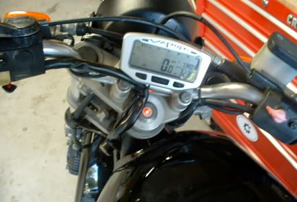

Monte,
My speedo is way off of calibration, and I am thinking about going with the Vapor instead of getting the existing speedo recalibrated.  I do have a few questions:
1.  What do you do do about the gen light bulb which is needed for the charging circuit?  Does the Vapor handle that, do you keep the existing bulb and circuit and bury it somewhere, or do you redneck engineer a resister or other solution into that circuit?
2.  Turn signal indicator - much wire cutting and splicing involved?
3.  If I want to go back to the factory set up, would that be any problem or issue because of any wiring changes/cutting/splicing done for the Vapor?
4.  What did you use to block/plug the speedo cable hole?
k_enn
k_enn
original owner of:
?1982 R65
? 2014 K1300S
Re: New to Forum, Motorcycles
« Reply #34 on: October 09, 2013, 01:15:13 PM »
Monte,
k_enn
1. Look at the photo of my Vapor install and spot the red GEN lamp neatly installed in the open hole where an Allen wrench would fit. I bought the smallest bulb and lens unit at RadiopShack -not an LED, slipped a very thin washer beneath it, ran the leads out the bottom of the steering head, fitted two butt splice plugs (so the GEN lamp could be removed if/when bearing work or whatever might be needed. A small dollop of silicone adhesive secures the bulb assembly.
2.  Unless you purchase the Vapor "surround" component, there is no provision for turn signal "reminders". I just deleted the Nanny State stuff. If you need/want the signal reminder, you'll need to purchase the needed accessory to the Vapor. You could also use one of the multiple light positions for an OP light, if you need one.
3.  Doubtful. But that depends on what you decide to cut.
4.  Hard rubber tapered bung plug from Ace hardware.
