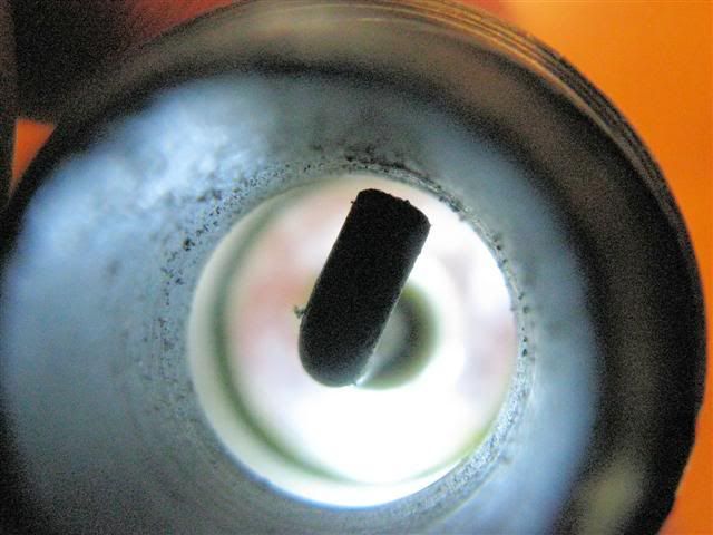

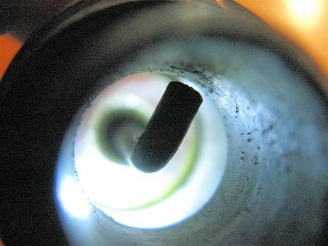

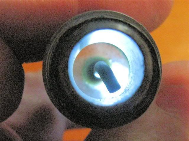

« Reply #3 on: April 17, 2008, 12:58:49 AM »
Bob, I think you might have a problem with a short in the Colourtune or too large a spark gap. In actual fact, the stock points and electronic ignitions of our Airheads put out very similar energy's/voltages, It's just that the electronic can do it more consistently over more conditions.
I've tried mine on my '86 Mono, as well as a couple other later ignition types with no shorting across the glass.
Maybe try really scrupulously cleaning the glass and setting the spark gap on the unit as close to stock as you can. Here's a few pics of mine from different angles of the electrode. Gap is pretty close to 1mm.
Bill.....................;-)

« Reply #4 on: April 17, 2008, 09:42:38 AM »
I've got the gap set to .028 in, .71 mm, so I'll try cleaning the glass viewing window to see if it helps.
