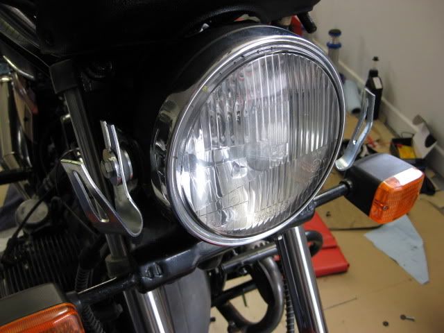

My latest attempt is an Emgo Fairing /screen, Its kinda a cheap S-Fairing type of thing.

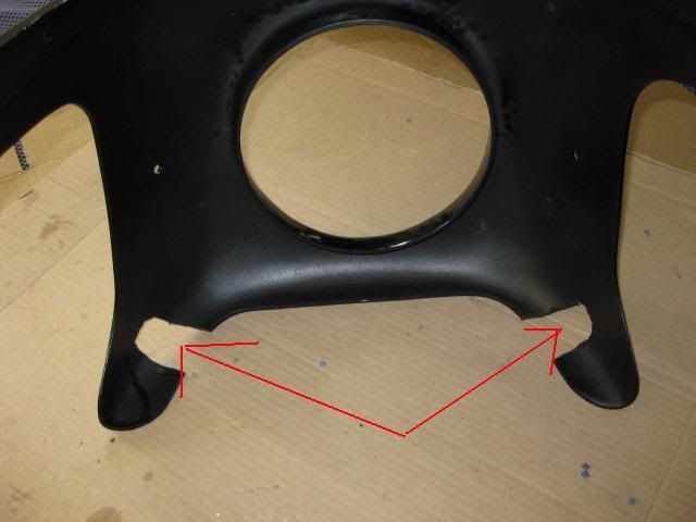

Its not a straight fitting to the R65, some cutting /modification is needed to the headlight fairing, though I found this relatively easy with a fine jigsaw blade.
Two cuts as shown above to clear the indicator stalks, I guesstimated these cuts and it worked OK, they are probably larger than required but are mostly hidden, if you are more patient than me,  ;) and are good at measuring up you can probably do a neater job

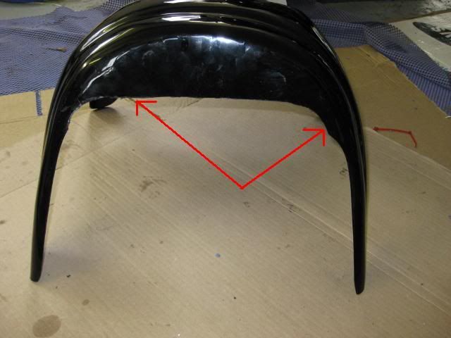

And one long cut as shown above to clear the instrument pod, One issue I had with the fine jigsaw blade I used was heating, causing the cuts to melt and refuse as they cooled, if you move the blade back and forth it helps keep the cut open, or possibly there is a better tool than a jigsaw for doing this type of cutting.
After that the next thing that needs adjustment are the brackets provided, I was told by the supplier I would need to make up my own as the supplied ones are for Jap bikes and will not work on BMW, Not sure why that would be, aren't headlight fittings pretty standard?
Anyway I found with some manipulation and bending, I could get the supplied brackets to fit, again I just used trial and error method:

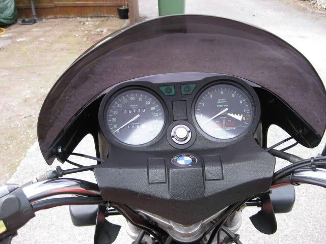

If you are considering, take a look at this pic to try and judge if your extra instruments will clear as I know the Givi gave you some problems in that respect:
Dizerens5
Re: Screen
« Reply #20 on: August 24, 2011, 04:37:55 AM »
Thanks for the photo - makes clear it would not work on my R65 due to the two extra pods, nowhere near enough room for them. I'll get back to working on the Givi. Didn't realise cutting a screen without damaging it was such a long business - keep finding myself reaching for the tinsnips!
