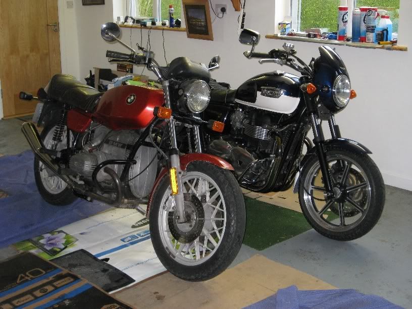

Planning to collect her tommorow, R65's are pretty rare here so I had to travel 190Km to find her, Initially I was going to take the Bus or Train have the seller collect me, and then ride her home, but after consideration ( Its not been ridden very much at all, and only serviced once in the last 4 years), I decided against and have hired a guy with a van who specializes in transporting bikes.
Its costing me €150, but I figure worth it for peace of mind.
And preparations are being made for the new arrival,  ;):

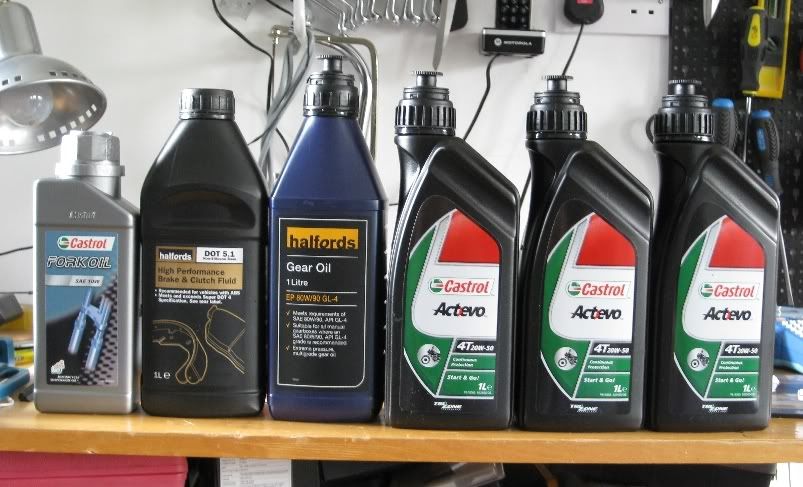

Impressive display of oils you have there Mike.

Well I went west again Saturday (West Clare) to collect the new family member, she's in her new home now, Two twins to keep each other company,  :)
Oil and filter change done today, also plugs and air filter.
Checked final drive and driveshaft levels, driveshaft was well down, had to add about 60cc, (Will be changing the final drive, driveshaft and gearbox oil shortly anyway)
Temporay job to secure the seat, Pumped tyre's Then went for a spin,  :) motor is running very nicely, though after the new oil the idle is a bit too low, Bike handling very well on good roads but a bit unsettled at the rear on rough/ridgy surfaces, Rear tyre not great and I suppose original shocks can't be up to much at this stage, Still all in all a good baseline to start improving upon.
