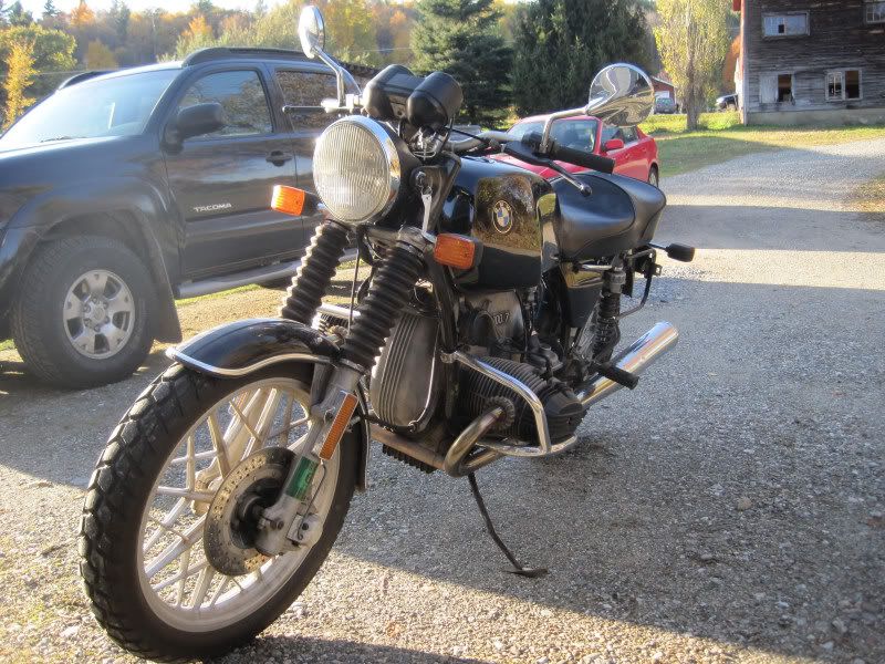

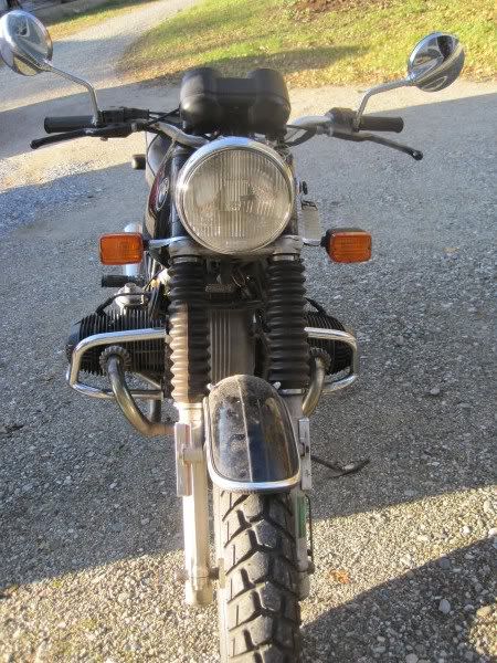

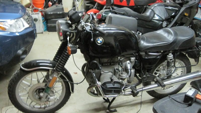

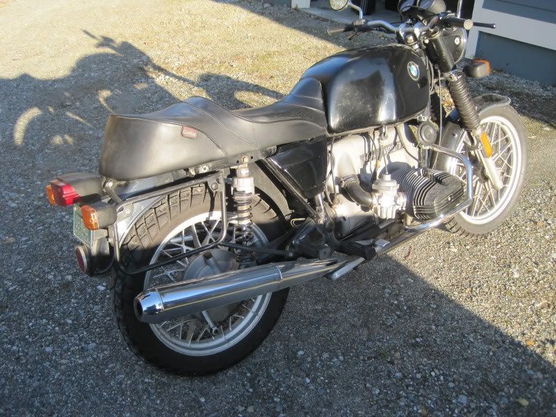

In spite of the economically-sketchy times, I've been keeping an eye out for an 'affordable' R90 or R100 airhead in decent mechanical condition (some TLC needs acceptable) to eventually pair up with a sidecar of some sort and I came across this 1979 R100 for sale less than 1 mile from my best friend's house (200 miles from my house), tho).
It has had a long life (107K miles) but has been apparently reasonably maintained, and just had a full front to back go through by Max BMW in 2009.  The seller put some new on/off tires on it for dirt road riding, but it does also comes with nice condition Krauser bags and bolt on rear luggage rack, Dyna ignition, nice leather Corbin seat and Works rear shocks.  His reason for selling it is that he has several young kids and has no time to ride it - I took it for a spin and it seems pretty good, though in need of some front caliper adjustment/cleaning, I think and some other small items.  The odometer is working well, but as usual, the speedometer is completely wacko (indicated between 50 and 75 when I know I was doing about 40)..  Am I a complete fool for thinking of paying $2500 for it?

Ended up giving $2400 for it - I could have probably knocked another $100 or so off it but decided not to press too hard as the young guy's wife is about to have their 2nd child any day now.
It comes complete with an oil leak or two, carbs and cables that need adjusting & synch, and a speedo that really needs help (like many BMWs, the odometer still works perfectly) and an exhaust leak at one of the header-to-muffler joints (Aftermarket mufflers), but my fingers are crossed that there won't be any big unpleasant surprises..
Oh, and after checking the VIN the bike was built in November 1977, making it a 1978 model, not a 1979 as advertised and registered, but I am assuming that it was sold as a holdover and got registered as a 79.  Numbers match, too.
{Edit: Front tire is Bridgestone Trailwing 100/90x19 (same as on V-strom), rear tire is Pirelli Scorpion A/T.    Definitely more like tires you'd expect to see on a GS airhead than a "street" airhead.  Maybe they are good on dirt roads and/or bikes designed for them but from my 4 mile sample ride on pavement they are NOT very confidence inspiring, leastwise on this bike's geometry - I'm gonna check the steering head bearings soon - things seem suitably "snug" with 0 play, etc., but there is no BMW std steering damper on this bike and it seems a little TOO easy to turn the bars from side to side/will readily flop over with no effort}
