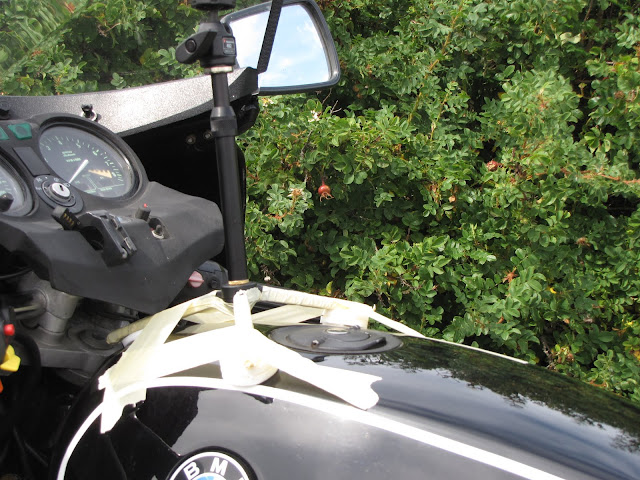

I am using a Canon PowerShot SX10IS mounted on a tripod strapped on top of the tank with masking tape. I am thinking of supporting the tripod on some spongy material to minimize the vibrations.
The camera is behind the screen and records the sound of the engine in stereo. It can be operated while driving.

Wow!  That seems like a lot of camera to have perched on your tankbag!  I take it the legs of your tripod are able to go flat?
Nice camera, though.  Are you able to interchange lenses?
trolle
Re: For those that use video cameras while riding...
« Reply #6 on: August 02, 2010, 07:33:52 AM »
Yes it looks cumbersome, but it works and I can handle the camera while driving.
Regretably the camera is with a fixed lense, but has a range from 5.0-100 mm ~ 28-560 mm and takes very good pictures.
