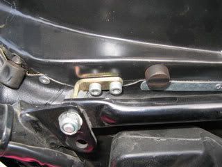

Re: Solo Seat
« Reply #23 on: July 12, 2017, 09:09:40 PM »
OK, I remember now.  I DID use the weird hinge for my solo seat.  (Pictures at home).
Unlike the eBay pictures of the /7 solo seat, the R65 hinge only fastens with 2 screws to the seat pan.
The threaded portion of the hinge replaces the top nut and bolt for the right-hand subframe/mainframe connection.
It mounts from the outside-in.
And there is an equally queer nut.  It is tapered to go where the tapered Allen bolt used to be (1st generation*) on the inside of the frame joint.
Tightening this special nut is a bit of a challenge, especially as it is a high-torque, critical (frame) fastener.
I used a screwdriver and hammer for mine.  I'm sure there is a really nice specialty tool out there, somewhere.
*this was a major change on the switch from 1st to 2nd gen.  This is one reason why the tool boxes from one will not work with the other.  (they are also shaped differently)
Also, because of this, the two generations have different subframes.  The early one has the tapered hole on the upper-right mount, the later ones have a standard hole, and used a standard nut and bolt, which sticks out into the toolbox area, while the early ones were flush.
« Last Edit: July 12, 2017, 09:13:45 PM by Rob_Valdez_79_R65 »

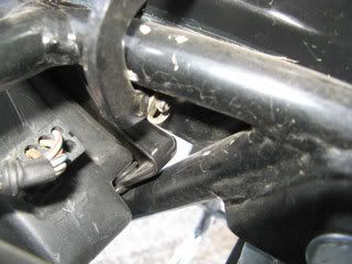

Offline DeeG
  • Posts: 226
Re: Solo Seat
« Reply #24 on: July 12, 2017, 10:03:25 PM »
Not the best shots, but it gives you an idea.  I can take more tomorrow if there is something specific you need or if you just want more.
