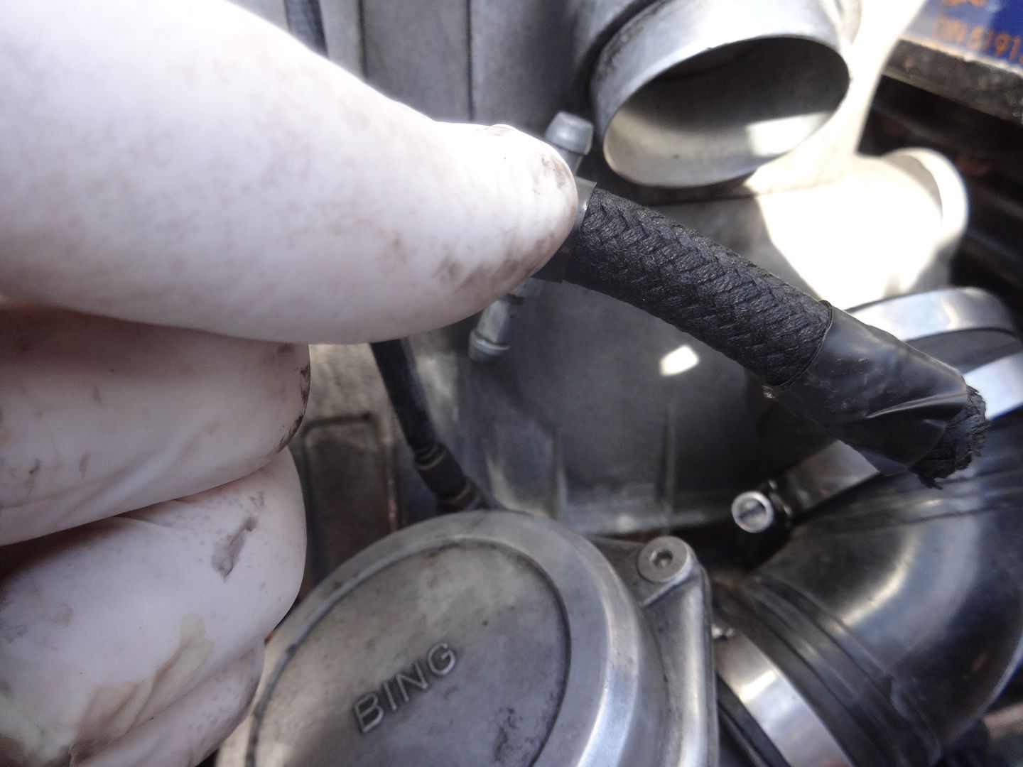

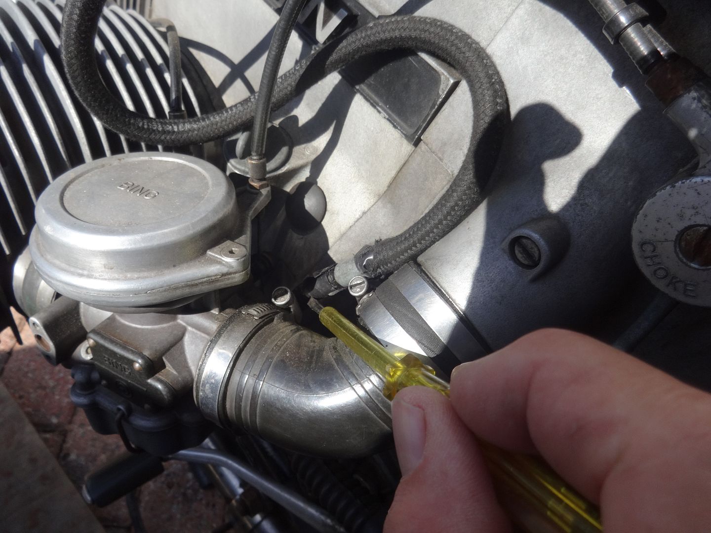

Turns out the floats are ok, the problem is a pin hole in the fuel line behind the carb.
