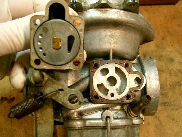

Welcome, Bill. Good to have another Texican join the herd.
As Barry says, the Bings are quite likely 'varnished' with evaporated fuel. There's also that tiny, brass "jet" in the enrichener reservoir that is easily fouled by evaporated fuel gum. Poke a thin single strand of copper wire through it. If closed off, the bike will be difficult to start when cold as no fuel passes through the enrichener/choke circuit.
Betcha you didn't know there are small 'carburetors' attached to the Bings.
