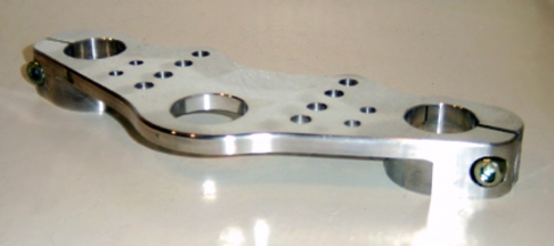

Also still would like to know fitting top yokes/triple clamps from other bikes/makes/after market, found eurotech 31426
http://www.eurotechmotorsports.com/details/images/BIG/31426.jpg if there are others let me know
