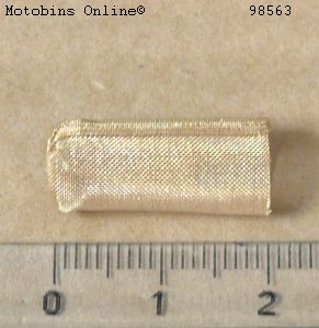

« Reply #11 on: August 25, 2015, 06:25:05 PM »
No wire mesh filters over the straws of the R65-specific single petcock on either of my R65s.
Someone stole your mesh filter Monte!
Motobins can supply you with a new one for GPB2.
Motobins Part No. 98563
BMW Part No. 16 12 1 233 368
Picture below.....
The post 85 taps (which fit perfectly) have a different design mesh sheath which is even better. Motobins were sellign the sheath type mesh seperately, but it no longer seems to be listed.

Re: in line fuel filter
« Reply #14 on: August 26, 2015, 02:20:09 AM »
That's the filter I have. I tidied up the bottom end to stop it fraying by dipping it in solder.
