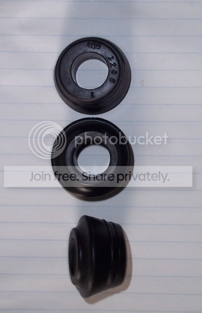

Replaced to pushrod grommets on my 79 r65 following Chris Harris's You Tube directions. Everything went smoothly.  After everything was torqued down, I noticed one of the grommets did not appear to be seated properly.  There appeared to be a faint bit of space between it and the engine sump. I tipped the bike on it's side to pool the oil in that area and after 5 min or so, I could see a bit of oil  had seeped from both grommets.  Did the same to the other side and a very faint amount formed on one of the grommets there.  Bought them from Max BMW, part no 11111355090 . One thing I noticed is that the old grommets are symmetrical, the bought ones are not.  Could they be wrong for this bike?  Inc. a pic. of the old ones. Any thoughts about what went wrong?

The pushrod tube seals are cone shaped, or eccentric, off center .
I believe if you look them, thee is a line molded into them  at the top .
That line should be up, not any where else .

You have the correct parts .
Just need to check the installation .

The alignment lines are in a down position, no sealants were used, I used some rubbing alcohol to get them on the tubes.
Is it possible that the tubes are slightly askew, and is there a way to check this?
Both sets of pictures are of the old grommets.
