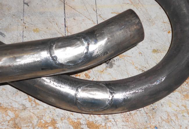

With my 1983 R65, which had rusty but solid headers, I removed the x-over pipes, cut and ground away the header pipe stubs, used the now junk x-over tubes to shape blanking plates for the headers and welded them in place.
   One-inch wide, tan-colored fiberglas heat wrap from Jeggs hot rod supply and stainless steel ties completed the job. Norton Dunstall-style mufflers completed the exhaust system's overhaul.

The '83 R65 pictured has EMGO -off shore mfg- Dunstall repops. They are chromed. Inlet ports on the ones I received required the use of the included brass adaptors. My '81 R65 has the same Dunstall-look in stainless steel from EPCO and have 35mm inlets. Not sure if EPCO is still in business.
The tan fiberglas heat tape is 1-inch wide from Jeggs. For best results and visual good looks, you must overlap each preceding turn by a factor of one-half. Otherwise, you will end up with a lumpy looking wrap job. Install requires soaking the 'glas tape in water to rinse away most of the short, loose glass fibers. Also prevents these unfriendly bits from being drawn into your lungs. Same safety precautions here as when working with glass cloth and resins. Both ends are secured with stainless steel tie-wraps avail at most Big Box home improvement stores for far less money than Jeggs requires.
