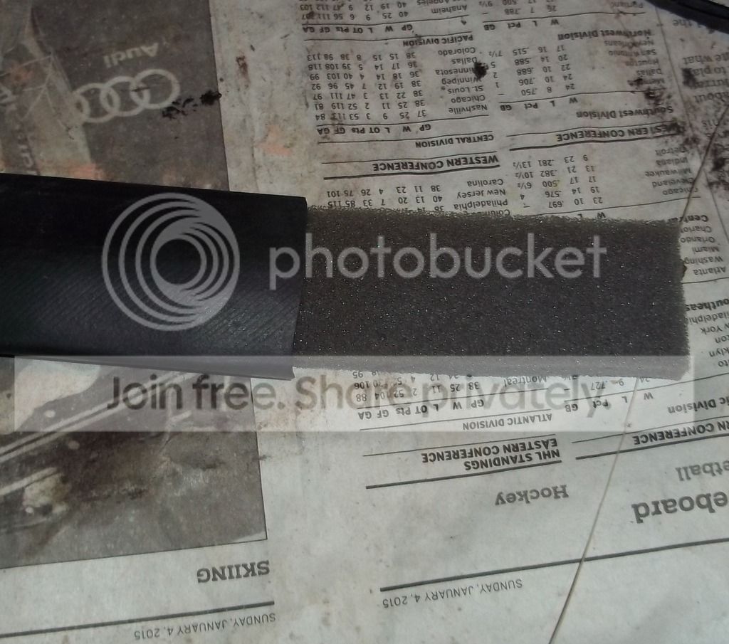

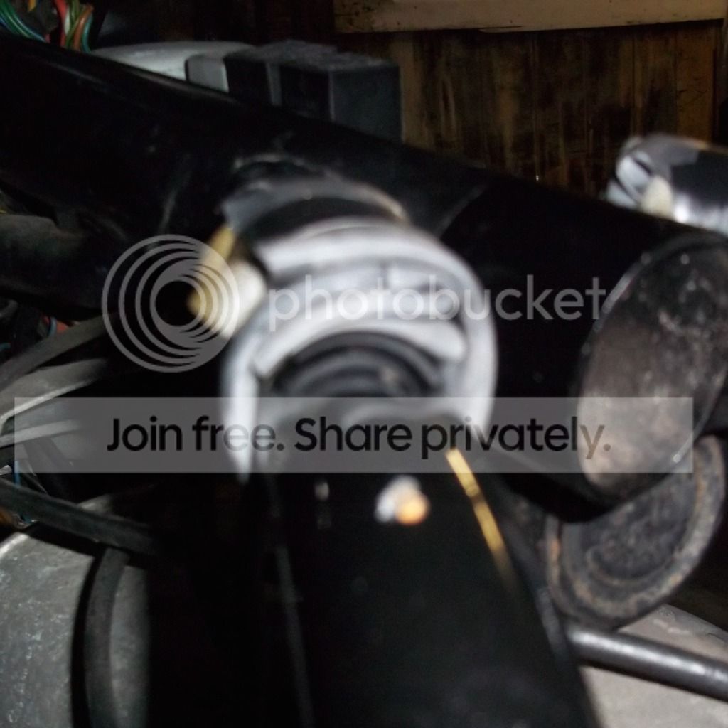

This is what I am doing. Took a bicycle inner tube, app. 9 inches in length and slipped some soft foam rubber into it.  Folded the end back an inch, twice to get a thickness of 3X the tube. Wrapped the tube round the frame. The top of the tube is covered with 4 thicknesses, the sides with one thickness to this inner tube, foam combo.  Used electrical tape to hold it in place. A little wd40 and the tank fits on nice and snug. (Sorry for the blurry image)
