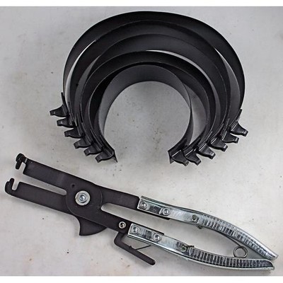

I have used this kind of ring compressor on engines that load from the top and they work great.
I think it would work well on bottom loaders.
When you squeeze it down it locks tight and it is thick enough it wont slide down between the cylinder  and piston as you push it in.

« Reply #49 on: November 23, 2014, 03:34:25 AM »
Here's photo of my ring compressor - a relic of my days spent playing with VWs. What I like about it is that the "ribbed" nature of the compression band means that once nicely oiled up the compressor will slide easily down the piston as the piston feeds into the cylinder.
