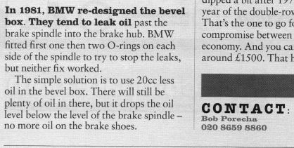

« Reply #5 on: September 08, 2014, 09:47:04 AM »
I could have sworn that as well as increasing the number of O rings BMW also recommended reducing the oil level but I can't find the reference and I noticed it wasn't mentioned on the service bulletin. I did find this from a well respected source and there is a general view that a little less oil in the final drive would do no harm at all.
Having a through sleeve is the real fix and what BMW should have done in the first place. Not sure if all post 81 models have the brass sleeve which makes that mod possible.

just replaced the O rings and topped up with a little less oil, all seems ok ,i guess ill find out over the next couple of days, but havnt replaced the shoes yet just in case. l looked at the bevel case & cover again & definatly only have the bronze bush in the bevel case ,in the bevel cover there is only alli
