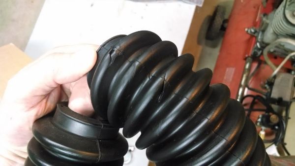

That's great Al. Can you ship it to New York?  Let me know how I can send postage. I'll pm you the address. I don't mind the split, at least I have something that fits until I get my hands on new ones. Many thanks!
I have a pair of stock R65 gaiters, I went with boots instead. They're used, and one has a small split, but let me know if your interested.

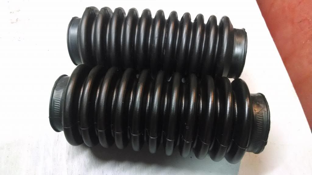

Got it Monte, sending out inquiries to BMW suppliers. Too bad our BMW dealer here is relatively new and sells newer models. The one that got to sell most of the Rs closed shop long time ago. And it can be a chore going through our aftermarket.
As I mentioned in my earlier post, I snagged that photo and part number off Hucky's site just to show what the boots with fewer ribs look like. To determine which boot would be 'correct' for your R65, suggest calling with upper and lower diameters of the stanchion and lower slider. As there were no "R65 specific" boots, you'll need to confirm with the seller.

Update on the gaiters:
Chopped off a couple of ribs from them and secured them with zip ties. (Gotta get some of those s/s clamps later). Also drilled a small hole to release some air. Looks okay for now.
Now if only I can bbq some of these "spareribs  ;)

« Reply #23 on: May 06, 2014, 05:34:36 AM »
Here's a pic of the gaiters. It looks like you found a solution, but if you still want them, make a $20 donation to the forum, and I'll ship them to New York on my dime.
