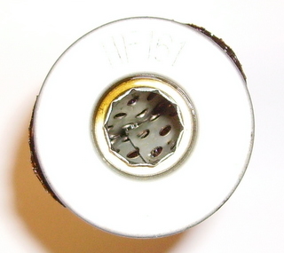

Re: 1979 R65 my 1st oil change ?
« Reply #7 on: April 07, 2014, 06:52:58 AM »
(If anyone is interested I have retained a couple to take photos of as a warning to others).
Many of you will have seen these before some 4 years back but talking of a warning to others this is what you don't want to happen.
« Last Edit: April 07, 2014, 07:03:56 AM by bhodgson »

Not trying to hijack this thread, but this had me concerned guys. The Last time I replaced my oil filter it was crushed flat, and I'm always having a flickering oil pressure light whenever I get the bike really really hot, like when I use it for more than 3 hours or when I get stuck in traffic. But when I use it for my daily commuting(around 30km), It never does that.
Is this normal or did I just do something bad?
I remember the oil filter cover leaking really really bad with a single shim and gasket installed, so I just put in another shim rather than remove the gasket. I never had any problems keeping the oil inside the engine after that.

Scary photos... every time I see 'em.
A benefit with the joined, 2-part oil filters is the substantial gains in strength of the filter's crush resistance. Yes, you will give up a small percentage in filter material but the benefits, IMO, outweigh the trade off. They're also easier to install. Allen head screws replaced those three bolts that caused so much squawking and lost time during a filter swap.
With cold weather, the Airhead engine generates massive oil pressures at start up. Even in temperate climes, slow revs during warm-up are life insurance for the engine. Let the UJM racer boys do their 5-6K rev "warm ups".
Lawn mower air filter! I can see that happening with a twit for a club's buyer. >:(

When I discovered that my filter was crushed I hadn't noticed any problem with the oil light. It went off normally at start up and never came on again even at idle.  I probably didn't experience anything like your high temperatures though as mine was crushed in the winter and the oil changed in early spring.
Hope you have escaped with out any damage.  You can check the filter easily without draining the oil by putting a couple of 1" planks under the wheels and then with the bike on the side stand it will lean over more than usual. The cover can be removed for a visual inspection of the filter with the loss of only a few drops of oil. Feeling in need of some assurance I did that a couple of times after the oil change following my flattened filter.
Your experience is a perfect demonstration that the cover gasket is not there to keep the oil in as if the $2O00 ring is doing it's job there will be no oil at the cover gasket interface. Some go as far as to suggest that if the depth calculations allow you are better off without the gasket as the cover joint would more easily provide a tell tale leak if something is amiss with the filter installation.
