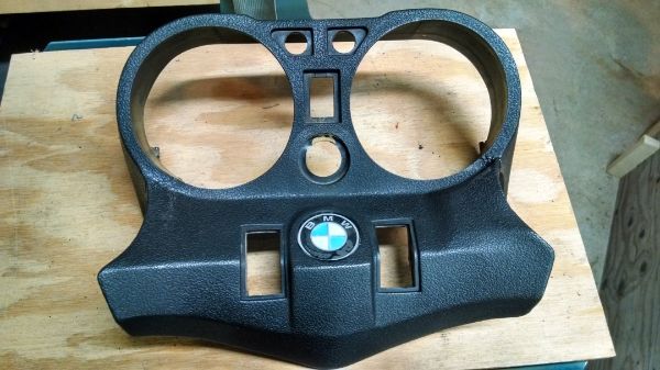

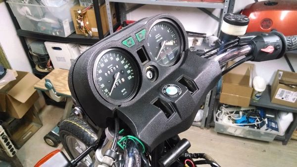

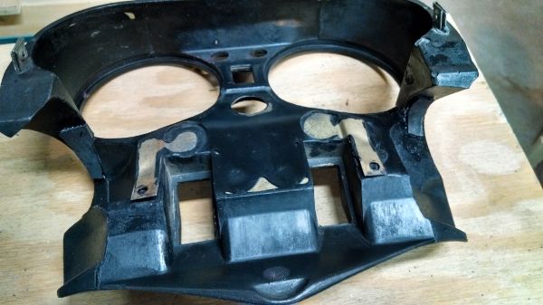

Well, that was not difficult at all. Super glue, some rubber material as backing/reinforcement. We'll see how it withstands installation and use...
Still a little clean up to do:
livingdeadhead

looks a nice tidy job ! would strips of steel been not as noticeable ? might get mine back and do that. which super glue did you use the flexible stuff ?

LDH: I used rubber because I thought the flexibility was important in making it more durable.
I used Gorilla brand Gel Super Glue
