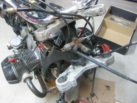

Hello, converting to twin front disc and wondering where the stock 3 way hose splitter mounts. thank you.
Re: Dual front disc distribution splitter
« Reply #1 on: February 23, 2014, 05:10:51 PM »
It bolts to the headlight/instrument bracket, right in front of the steering head.

Can I add further that using the otherwise redundant 4th "port" on the splitter you can install a VW Kombi (1968-1974) brake light pressure switch, which is orders of magnitude more reliable than the stock handlebar switch.

Mine('79) had the switch on the splitter stock, or at least that's how it was when I received it:
Thanks for this - I have this unit too and now I know exactly where it belongs - that VW switch is very useful to know too  ;)
Ah! I didn't know what was stock, let's face it we are dealing with 35 year old motorbikes. My wife's came stock with a single disc and a friend visiting Germany bought the complete twin disc conversion. Whilst fitting it I noticed that the handlebar switch was dodgy and investigation revealed that a VW brake light switch screwed in perfectly in place of the blanking bolt.
To answer someone else's question I removed the wiring from the handlebars and decided that the hole where the switch had been was virtually invisible. I looked this morning and a wasp has long ago made a nest in the hole and sealed it with mud.

That was the set-up on the '79-'80 (and '78 in Europe) R65s.
I had to replace my switch when I ignored the brake fluid maintenance long enough for the switch to gum up, as well.  :-[
