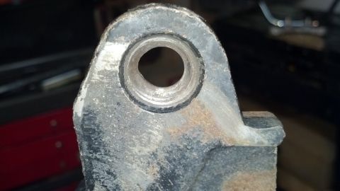

I'm dealing with the same issue. At least part of my problem is that the screws were loose for long enough to have elongated the countersunk holes:
I'm not sure what, if anything could be done about that, especially now that the frame is powder coated. Just tightening them made the stand more solid, and helped the angle, altho I still think it should be more vertical:
I think I'll build up a little weld on the stand's stop surface and it should be ok.

Al I would drill that counter sink out and sleeve it...... will bring you the welder if you pay for the ticket........

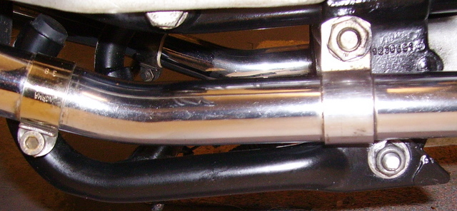

Someone else in this forum, in the relatively recent past posted lovely photos of the stainless steel strap they welded over the "stops" end of their stand.
I have to say that their method was/is much neater than my approach of simply building up the ends with weld.
I am going to do the fix with stainless steel strap to my wife's bike in the very near future. She has been grizzling for years about how hard it is to get on and off the centre stand. We bought her a new stand (and side stand) which let me tell you is an interesting process for a 1979 model, to BMW's credit they didn't have a side stand in stock and they issued orders to the foundry that originally made them to knock them up 6, one for my wife and 5 to put into stock.
Sorry, digressed. SHE complained that the new stand only partially fixed the problem, but I ignored her as at the time I could not see any way to improve the situation.
I now realize that in fact it is the frame stops on her early model frame that have worn down in the past 35 years. The frame is too bloody hard to get at and I am unsure if the stops are cast iron or forged steel - using the wrong rod could cause a world of hurt, so I am going to use strap to build up the stand as that I know is bright mild and will not be harmed by welding to it.

It's my stand that has the stainless steel strips welded around the curved part of the legs but I didn't do any photo's other than the one in my post above which only shows I blended them well enough not to be easily noticeable. There's no great secret other than to use some lengths of stainless strip pre-curved to fit. Tack it in place and weld with stainless rods.  Followed by a lot of time with the angle grinder.
