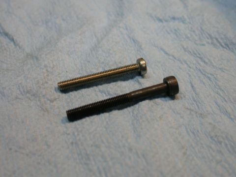

Ok, I'm back. I got longer screws at the hardware store:

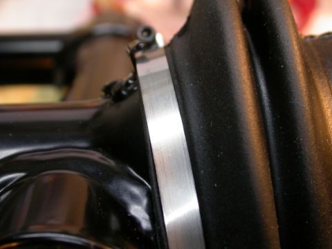

Using one of those I was able to get the clamp on easily. I can't see it ever pulling off, and I doubt it will leak, but I still don't like that the swingarm's mating surface is more conical than cylindrical. I tried to get a picture showing the way the clamp distorts trying to conform to the swing arm profile:
Looking at pictures of other swing arms for sale on eBay, it seems like at some point the "flange" was made more cylindrical.
Re: Swingarm boot, anyone tried the Max version?
« Reply #21 on: February 20, 2014, 07:24:15 PM »
Mine was not round.  No biggie.  The clamp can take it.
