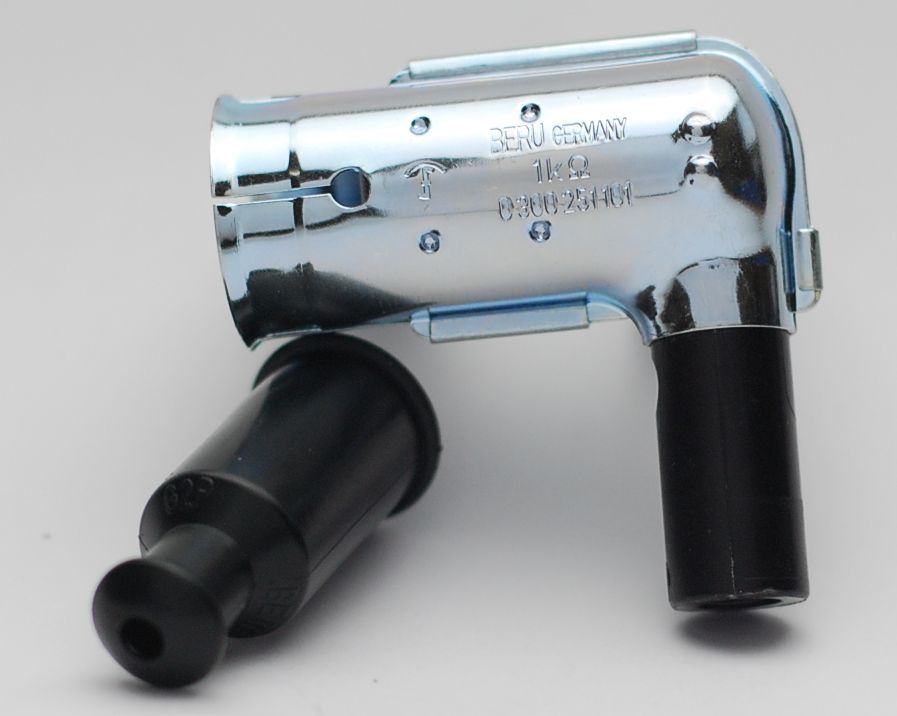

I've seen somewhere metal caps identical to the OEM one but easy to assemble. Can't remember where ...
Could it have been Beru.  They are available in 1K Ohm and 5K Ohm versions and cost 5 -6 Euros.  Article here on rebuilding Beru caps http://faq.f650.com/FAQs/PlugCapsnCoils.htm#Beru%20Spark%20Plug%20Cap%20Rebuild:

Points ignition bikes should have 1000 ohm caps.  Although 5000 ohm caps seem to work if you really want 1000 ohm caps, you won't find NGK caps easily in the UK. At at least I can't even though they seem to be commonly available else where.  The 1000 ohm Beru caps are available and at low cost. It must be the BMW supplied Beru caps with integral HT lead that are expensive.
