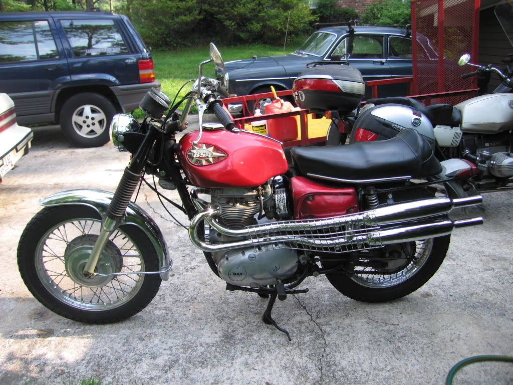

I've gone in a different direction....
Oo La la!
