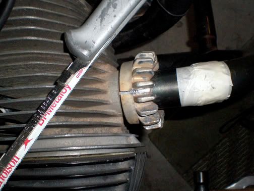

Couple tips for sawing off the butterfly nut...
Tape over the exhaust header so as not to scratch up the chrome, blued metal, rust or whatever. Do it before you begin sawing, not when you get that first scratch and then remember this tip.
Consider buying a hack saw blade holder as seen in the photo. Install the blade so that it cuts on the pull stroke, not  on the push, as you'll bend/break the blade. Use short strokes and watch not to scratch the aluminum head either. Slow and steady will git 'er done.
See the exhaust stub threads in the photo? Stop sawing and try the wrench. Tension may have been released and the nut will come off fairly easily. Maybe. If it's still tight, split the butterfly with a fat chisel; a slim one will drive right into the stub's threads. D'oh!
