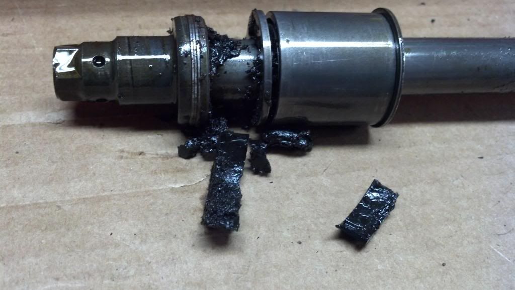

I took apart my forks. I don't know the history of this bike, but I know this isn't good

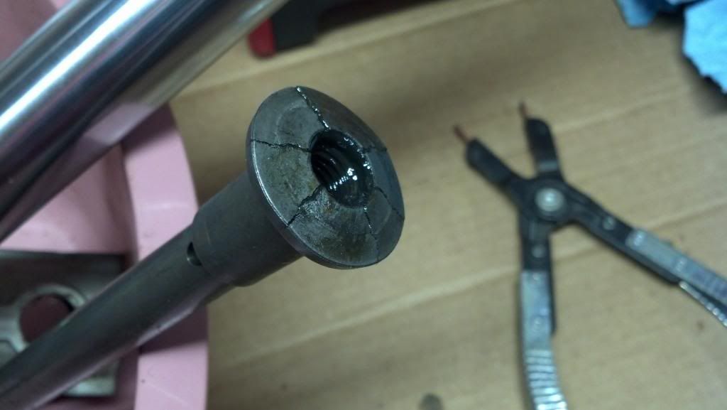

The last shot shows the "Support for Damper Pipe", which is mangled from bottoming out I guess. Likely from lack oil causing lack of damping? It's a replaceable part, is it pressed onto the damper pipe?

Ah, yes... the disintegrated rubber baby buggy bumper.
At least you know where the replacements will be located. The rubbery rings on my '81 R65 were nothing more than a very fine sludge sitting atop the Damper Pipe Support.
Which, BTW, just pulls off the damper rod... Although the mushroomed shape of your 'support' bit may require some judicious application of force.

I got the bottom "Support for Damper Pipe" caps off, one is completely destroyed, the other shows some cracking.

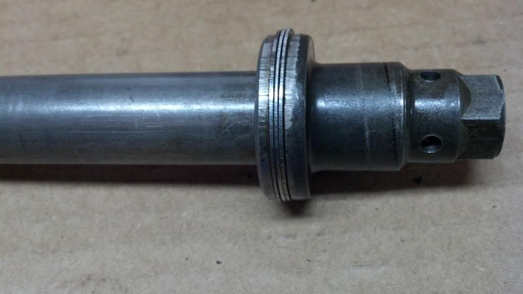

As far as the "rings":
There's obvious wear, to the rings and the top cap of the damper rod. Is this top cap removable? It looks like a separate part, but the fiche doesn't list it separate from the rod.
I don't see the rings called out on the fiche?
« Last Edit: October 08, 2013, 09:45:10 AM by AlfromNH »
Re: Fork Disassembly - yikes!
« Reply #6 on: October 08, 2013, 09:55:58 AM »
Yes the damper piston unscrews from the rod.
You have a dilemma with the rings though as the general advice is not to replace them. New stock are not good quality and reckoned to cause stiction.  There is a guy who recently had this problem and solved it in an ingenious way by turning out the ring slot to accept a later type plastic wiper.  I'll see if I can find the picture.
« Last Edit: October 08, 2013, 09:58:24 AM by bhodgson »
« Reply #7 on: October 08, 2013, 09:57:02 AM »
The top part comes off, but iti looks like the whole damper comes as one unit, individual parts not available .
There are two holes at the bottom of the tube, you can put a punch in the holes and then use A 13 mm socket on the to p to seperate the two parts .
I think the last time I did this on my '82 LS, I put a punch in the lower holes then put some thin pieces of wood in a vise and then put the punch and damper in the vise tightened it up and needed an air impact wrench to get the upper part loosened from the tube .

So if the damper rod comes with the piston, does it also include the rings?
At this point, I think I won't bother trying to get the piston off the rod. The rings look ok, so I'll replace all the rubber parts and put it back together.

Al -
Sorry to see but from the looks of that pic, I think you're gonna have to order new damping rod - you can check with Rusty, but I am pretty sure that they sell the rod with the top piston as 1 part.  You do have to buy the rings separately, and those rings are definitely too worn to do their job properly...
The thing we have to be careful of, is that even BMWs microfiches have errors - both of omission and inclusion.   So, sometimes one will see an assembly on the fiche with 15 parts, when there are only 8-10 parts to the assembly in any given flavor - they just included all versions/variants of the parts in the one drawing when they updated, added, or deleted part numbers..
FWIIW, Motobins P/N Part No.29000 BMW Part No. 31 42 1 232 059
Recently fitted 1 (At around $AU5 each) due to being a bit too rough feeding them into the stanchion. Seemed to pretty much match the existing ones.
I did consider putting the rod in the Lathe and fitting the plastic ring but didn't want to be a pioneer. Next time!
