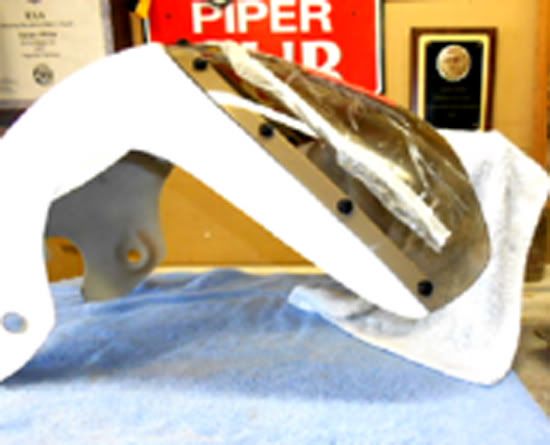

I'll share some details of my work in fitting a windscreen/fairing to 'ol Bengt Phorqs R90 and perhaps address a few of your concerns.

After removing the paint from your Wudo and exposing the gelcoat, yes, sand it. I used a 320 grit wet with a soft sanding block. Try not to sand without a block of some sort as fingers can actually cut grooves in the substrate if aggressively over-worked. Just clean the gelcoat in prep for multiple coats of sandable primer. Avoid sanding through the gel coat and exposing raw f'glas fabric. That'll create more work.
Should there be any deep scratches, fill with glazing putty and re-sand prior to prime.

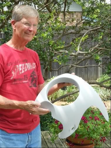

Mike's fairing and screen have been matched. The lower is ready for gel coat sanding.
