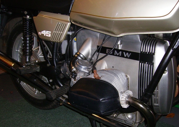

I never deliberately lug the engine but winter temperatures provide a dilema where you have to choose between lugging and reving the engine with cold oil. On my short commute low oil pressure is never an issue at any revs because the oil just doesn't get hot enough and cold oil is my real concern. I measured oil temperature of just under 50 Deg C  (120 F) when I got home the other night. I compromise and ride between 2500 - 3500 RPM with an occasional burst to 4000 and  I do what I can to reduce oil cooling by fitting my custom made valve covers when the temperature drops.  It's not enough though. I really could do with a sump heater.
