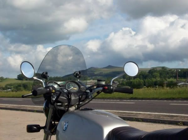

I changed mine for a more comfortable riding position after abdominal surgery Motorworks will match the brake line to the bars for you
these are the half rise barscorrection these are the RT Bars.

CaptainSlow
Re: Will I need extended brake lines????
« Reply #9 on: February 28, 2013, 02:51:52 AM »
Thats what I'm after! Thanks Lou

« Reply #10 on: February 28, 2013, 02:53:51 AM »
Made an error, they are the "RT" bars from Motorworks not the Half rise i still have the receipt.no need to alter the electrics there is spare cable in the Loom under the tank (BMW think of everything)

CaptainSlow
« Reply #11 on: February 28, 2013, 03:00:35 AM »
 ;D even better! I picked up an RT handlebar a few weeks ago on the offchance, as it was for sale at... £7 !
I've since found out there is a lot of work involved in fitting it - longer clutch & accelerator cables, longer electrical cables, plus a longer reservoir to splitter hose, so I'm going to try and use the std bars for a few weeks to see how I get on... but I reckon I'll be fitting the higher bars eventually as they suit my 'touring' riding style better.
Thanks for the pic - it confirms that I have actually bought the right item for a change!
