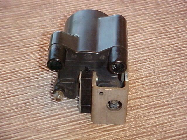

Mine doesn't look anything like yours...we both have the 1984.  It's all black.  I'll try to post a picture.
Re: My baby let me down today...ignition problems?
« Reply #19 on: May 07, 2007, 07:21:53 PM »

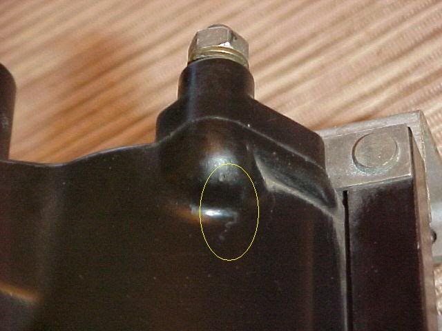

OK, here's a picture of my coil...
I found this little crack in the coil... (along with some others nearby)

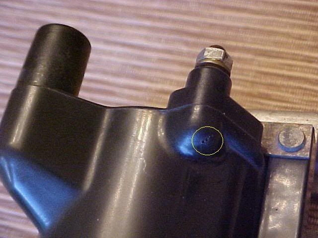

AND these little burn holes...

Steve, is there a part number on your coil?  Mine has the old Bosch number, wonder if yours might be the updated version?

I replaced my original crack-o-matic grey coil in '94, it just failed about 2 blocks from home, the secondary coil opened. I replaced it with the red upgraded OEM coil, and that coil went bad in '03, primary winding resistance was less than half of what it was supposed to be and caused hard starting below 55 F. I have listened to the reports on the dual output OEM coils from BMW, and the consensus is if you don't have to buy one, don't ! As far as needing to replace the ignition control unit, I didn't do it when I installed the OEM upgraded coil, and that was 13 years ago. I would think that if a problem would have occurred, I think with the environment that I subjected my '81 to ( desert heat of Arizona) should have caused a failure. Here's a tip that may save you some money, if you have to replace the electronic ignition control unit, Motorrad Elektrik has a replacement for about $60. This particular part was also commonly used on European cars in the '70's and '80's, so a store like NAPA or the equivalent may be a more cost efficient way to go.
