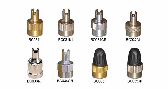

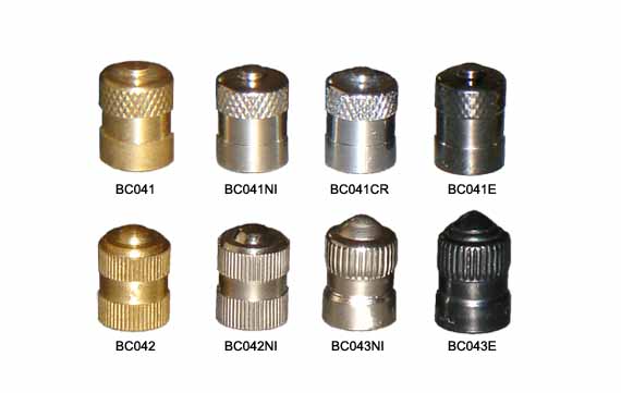

I use the valve caps that are used on my employers 737 aircraft, they are brass, with a recess in the rubber seal inside for the valve stem pin to rest in and not have a chance of depressing the pin .
Re: Slime to stop a slow air leak in a tube????
« Reply #14 on: January 31, 2011, 05:28:58 PM »
I have one like this BC035NI (original)
And one like this  BC043NI (good-quality replacement)
