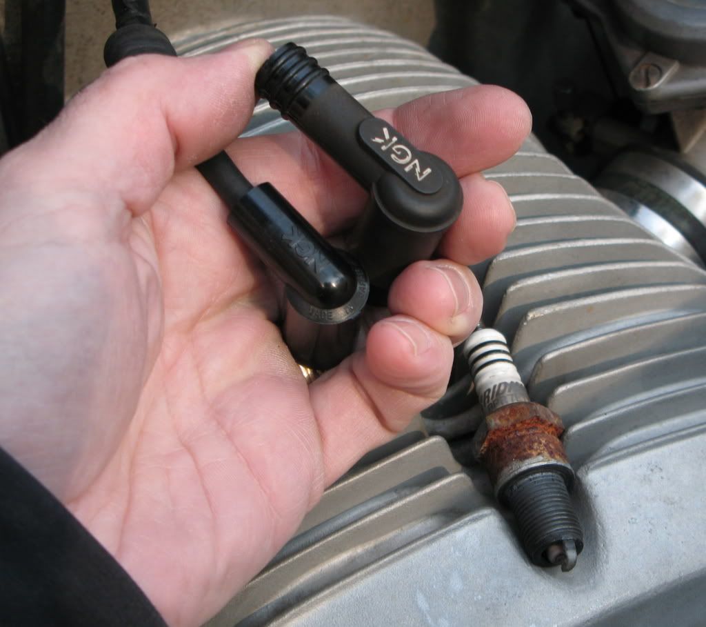

OK here is a picture.  The 5k ohm has a longer shaft that contains the resistance element and also has the raised section with "NGK" embossed on top.
The 0 ohm has a shorter high tension lead connection with the letters "NGK" raised alone.  In the picture it is the one connected to the wire.  BTW there is no erosion of the iridium tip after 30,000 miles.  Now the out side needs some attention tho.....

Well I'll be.  Hey that looks like a resistor cap though.  It's got the longer shaft.
