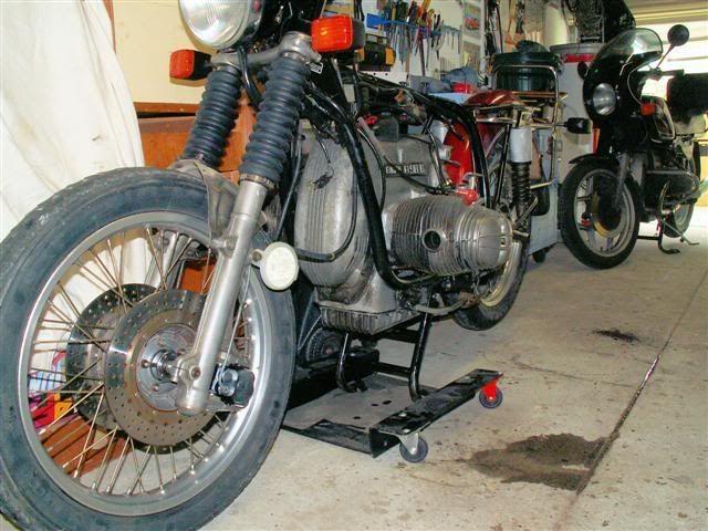

Who needs a bike lift?? (But then again, who wants a bike lift??.............Me!!) Due to space and wallet limitations I made up a bike dolly, as seen in the pic, for working on the 90/6. Makes it easier to push into a corner for space when needed. That pic was when it was coming apart, it's now in use again for the rebuild, even though I have the swingarm in. I intend to install engine and gearbox as one so it doesn't matter that the SA is installed.

The dolly looks kind of neat.  I (my back) decided to get a lift after crawling around on the floor helping the kid change timing chain and stuff on the '80 when he started riding it.  Since we have 4 bikes in the garage the lift just occupies one bike's worth of space and always has something "parked" on it.

Cheers for that Bill, that wee dolly is a blood marvelous idea. I am definitely making my self one of them!
