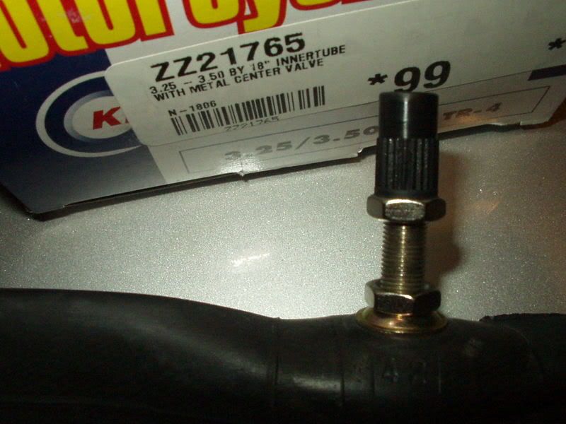

I've never seen a definitive answer on the short stem problem but My LS has it and here's my guess from what I could glean off various lists. Natural rubber tubes (green stripe) have "welded construction" and 1 nut used for installing that can be discarded, run up the valve stem against the cap or someother. Lots and lots of pompous spouting and frothing can be found on what to do with the nut. Butyl rubber tubes (blue stripe) and some natural rubber have a metal flange / nut / fully threaded stem arrangement where there is a second nut that holds the flange/stem thingies* together to the tube. It's this tube /stem/flange nut cobstruction residing inside the rim that causes the stem to be so darn short. Can you remove it? Um...I'll get back to you.
Rich
*AKA Hootus
