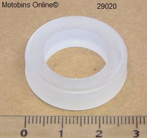

These are the bumpers I got from Max BMW:
These are the ones Motobins sells:
I noticed the inside diameter of my new ones is slightly larger than the old one I pulled off.  (The one in the other leg was no where to be seen)

Perhaps I misread/misunderstood previous posts. RealOEM for my '81 shows the same exploded view of the front fork innards as the diagram in your post. Item #24 is the rubber/nylon "ring" above the perforated disc.
I'm going to fit the Motobins rings in the '83 as the fork legs are currently off for the steering stem bearing replacement.
