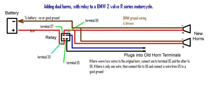

« Reply #18 on: January 09, 2009, 07:57:41 AM »
One commonly available relay (in the states) is the Radio Shack 12 volt automotive relay Model: 275-001.
there are four terminals - 85, 86, 87, 30.  Unless your horn came with, one pick up an inline fuse holder with the red wires attached - Radio Shack has several; as long as it is over 10 amps rated you should have no problem.  Use the hookup wire that came with the horn or #10AWG.
Connect the two wires presently going to the horn to terminals 85 and 86. These are the relay coil terminals - polarity does not matter.
Connect one end of the fuse holder to the + of the battery and the other end to terminal 30 of the relay. Connect a wire from terminal 87 of the relay to one terminal of the horn (+ if it is marked such, usually it only matters for air horns). Connect the other horn terminal to a GOOD chassis ground.

« Reply #19 on: January 09, 2009, 06:01:23 PM »
If you are installing a pair of horns, do you wire them in parallel or series? I bought some 14ga wire today for this job. Is that going to be insufficient? Where is it best to mount the relay? Room for any of this in the fuse box area? And finally, do coiled trumpet style horns need to face downward to keep from being damaged by debris?
Thanks guys,
Will

« Reply #20 on: January 09, 2009, 09:30:57 PM »
Wire the horns in parallel - the power line should run to the same terminal on each of the horns and depending on whether the ones you got have a separate ground terminal or just ground through the mounting bolt the grounds just have to get to a good electrical frame connection.
14 AWG should be fine for the horns.
Point the trumpets generally downward so that they don't fill up with rain water and grit !!!   They don't have to be exacty straight down, but should be pointed generally down and either to the rear or to the side for sound dispersal (.ie don't point the trumpets inward toward the center of the bike and each other - they'll still be pretty loud, but won't project as well).
Usually there is space for mounting an extra relay or two on the relay bracket that is under the fuel tank, where the other relays are.   It keeps things all in one place, tidier, and generally out of most of the rain, etc. and usually in a path from the battery up toward the horns mounted on the front of the frame.

« Reply #24 on: January 11, 2009, 10:54:49 AM »
OK you use the OEM wires to the OEM horn to activate the relay and do you go all the way back to the battery to get the power or is there another suitable source under the tank? I gather you take TWO leads from the relay, one to power each horn. I have some 14 GWA wire for the run from relay to horn. Do I need larger (10 or 12) to run from battery to relay?

« Reply #25 on: January 11, 2009, 01:14:36 PM »
You can use the original horn wire from the button to run the relay.
You should go back to the battery with the 14 gauge wire to get the power.
If you use multiple 14 gauge wires from the battery then you should put an inline fuse in each one.
But, given that you probably won't be beeping the horn on a continuous basis the brief periods of  8-12 Amp current draw
from those horns won't cause much of an issue at all with the 14 gauge wire and only a few feet in length that it is from the
battery->relay and relay->horn.  I think that you're fine with a single 14 gage wire, with inline fuse.  Don't bundle it/tie-wrap it tight
with other wires all the way along the path, but do use tie wraps to keep it neat and tidy, etc.
If you want to be super-duper safe, you could go to 12 AWG wire, but that is probably  the largest that you could get and still use the same connectors as the 14 AWG to connector to the tabs on the relay or the horns.

« Reply #27 on: January 12, 2009, 02:11:53 AM »
The positive wire from Terminal 87 is a 'Y' - leaving 87 as one wire, then splitting into two, one for each horn.
from: http://www.boxerworks.com/phorum/read.php?f=1&i=243289&t=243185#reply_243289
« Last Edit: January 12, 2009, 02:13:57 AM by Rob_Valdez_79_R65 »

« Reply #29 on: February 07, 2009, 05:21:52 PM »
I finally finished installoing the horn this afternoon. I ended up buying a 420hz BMW horn to add to the OEM piece. The wiring was straight forward thanks to this forum's aid. The only decision was where to mount the relay (used empty space on sheet metal holding other relays under tank) and where to get a good ground (used an empty threaded hole on the same piece of sheet metal. Sounds very German ballsy.
