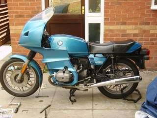

« Reply #1 on: July 23, 2008, 01:29:05 PM »
RS fairing is newly refurbished. Here's a preliminary fitting.
Took R65 off the road today and hope to get most of the fitting work completed during next week  ;D ;D . There seems a LOT to be done. In addition to actually getting the fairing fitted on, new brake hoses, change bars to allow continued use of R65 master cylinder, cables and wiring mods, and many more yet to be discovered no doubt. First major work to get a spacer for the headstock cradle that will move the whole fairing 1.5cm forward. As you can see the faring lowers aren't well lined up with the cylinders. Bars and forks need the spacer to allow free movement. Most annoyingly BMW have tapped the headstock to accept 8 x 1.12 mm bolt threads, talk about unobtanium. I have a pair of used ones on the way but worry they may not be long enough for the spacer.
So  I'm not surprised no one has replied to my first post on this thread  ;D ;D

« Reply #2 on: July 23, 2008, 03:47:46 PM »
Nice looking conversion,   ;D I don't know why more people don't do it!  Although this is a one-off hand laid copy of an RS fairing it is identical in size and uses the BMW mounting hardware.  I put progressive springs in the forks and have Konis on the back and the bike handles well with no damper needed.
