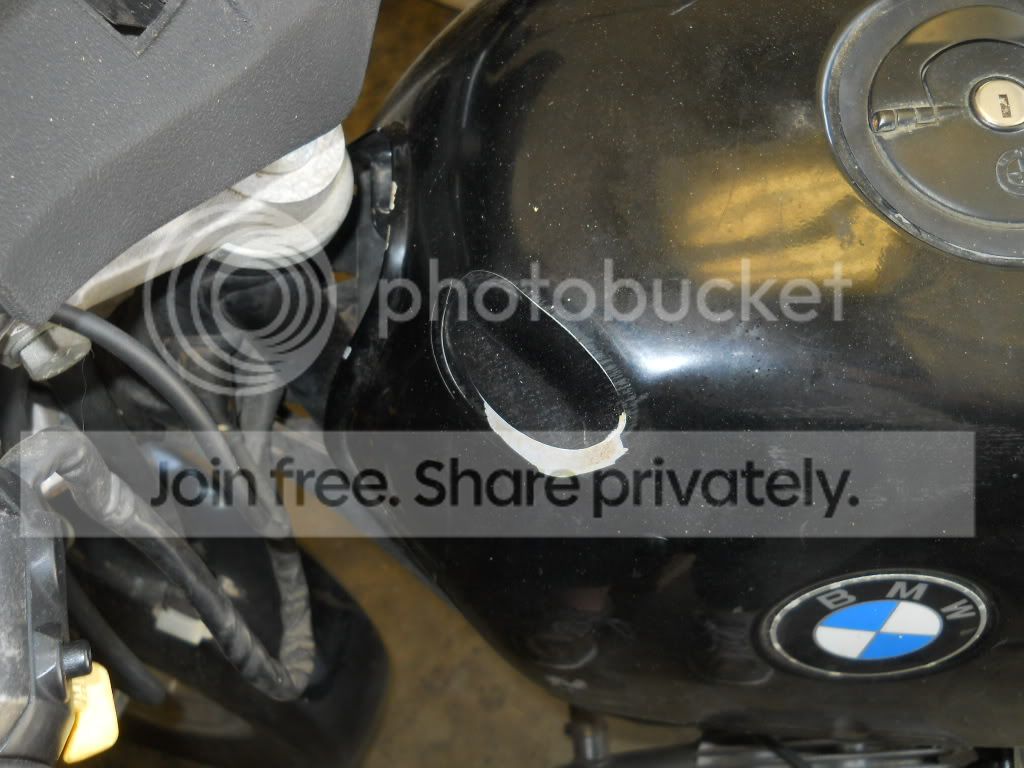

MY tank dent that took the wind from my sails..............

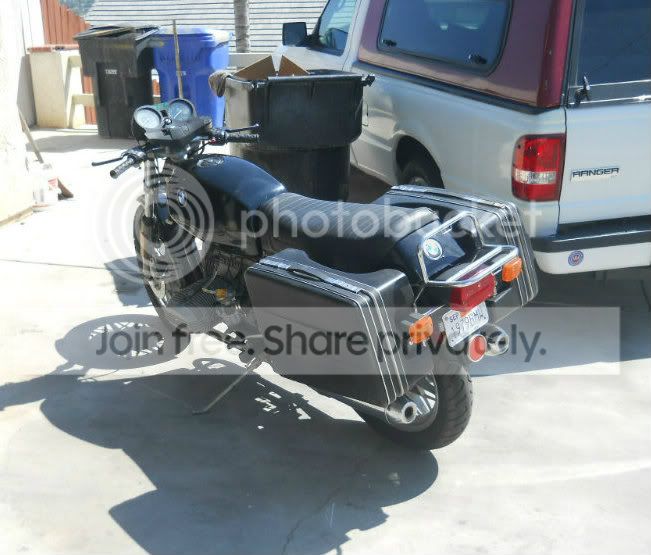

I fitted the bags to the new rack.  and washed the darn thing backed it out and have been making 10 miles jaunts looking for things to fall off. So far so good. It runs well enough that I will just address the cosmetics for now. Got a lil head shake when I turn loose of the bars and the new Shinko tires don't fall in very well on corners. The corners could be me too , haven't been riding much in the last year(maybe not at all) and at my state of antiquity the rust forms quickly.

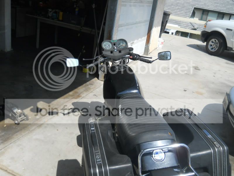

you're bike looks sweet!
clean, but i think you're missing some mirrors!
you don't like the shinko's? i like mine and i can get down pretty low in the corners which is nice to have that in my mind in maneuverability.
what bars do you have there on the bike, they look lower than mine and i think i have the low euro bars on mine

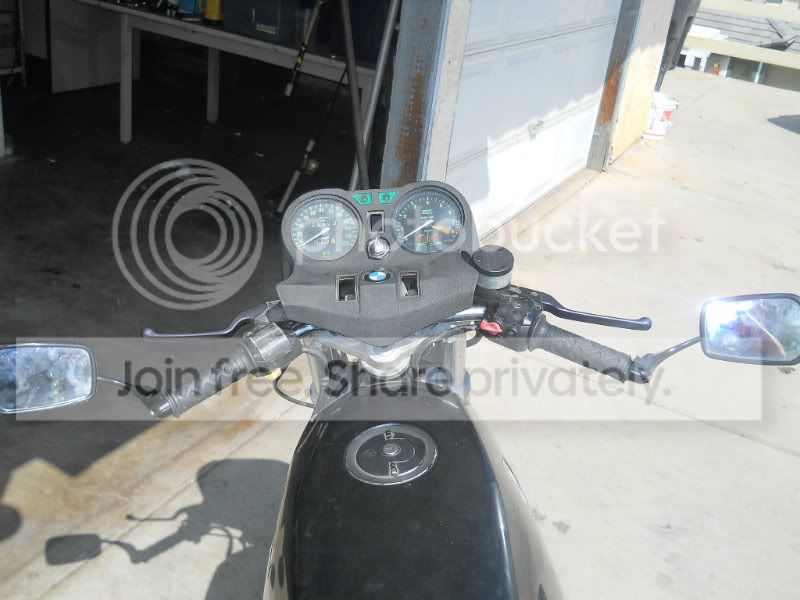

The bars are flat bars(r90?) worked good with the fairing. The bars are the problem I'm having with my mirrors. The flat bars do not allow the throttle control to slide up high enough to use the Napolean bars ends I got. The twist grip ends up hanging over the end of the bar by an inch.

While waiting for the stock low bars to materialize I put the flat RS bars back on and trimmed a bit of the dash panel, trimmed a little off the trottle grip and moved the bar as far to the right as I could and the bar end mirrors just fit. Took a little 2 miles ride on bumpy roads and the mirrors didn't move so I guess they're as tight as they need to be. On my short ride I didn't notice that I had an inch more bar on the right, it was transparent to me.
This will get me back mobile again so I can finish off the other things I need to do.

Re: trying to get back on the road..........
« Reply #12 on: September 11, 2012, 10:41:10 PM »
Really not noticeable to the casual viewer.
Interestingly, I have grips all but identical to yours on both my R65s and find them more comfortable than the larger diameter grips often seen on other Airheads. OEM low euro bars on both bikes and no wrist or back issues.
Joe, that's at least two bites of the elephant. [smiley=thumbsup.gif]

More of the "E" has been digested. I tossed the bar end mirrors and put the handle bars back in alignment and reinstalled the fairing. I have been about 50 miles waiting for something to fall off, so far so good.
