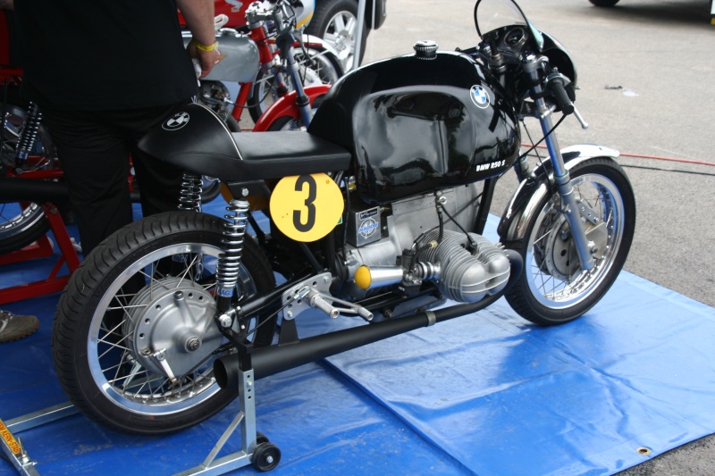

This is from a series of photos from Belgium, from a thread on ADVrider.
Not the source I was looking for (this is the only bike with Hagons on this thread).
I know I saw another...
click for the thread
