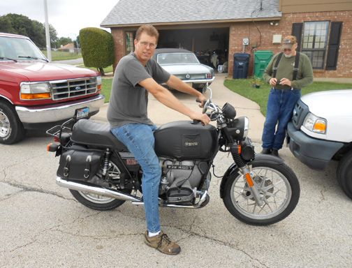

Spent a couple days this week assisting a friend in getting his 1978 R100/7 back into a safe and roadworthy condition. The bike is quite the bone-stock beauty but deferred maintenance created a lengthy Tech Daze list which included: New Metzler tires, tubes and balance; front disc pads and adjustment of the ATE caliper; new brake hose; MC clean out, flush n' bleed; engine, trans, drive shaft and final drive lubes; oil filter; new battery; replace all fuel lines; rear brake shoes; final drive splines cleaned and greased; and a new air filter.
The air filter was pretty much the last item before an afternoon road test. Pulling off the clam shell cover revealed a mouse's informal digs. Cozy nest and plenty of his droppings to clean out. The up-side is the rich running condition went away!
Props to Mike "Bengt Phorqs" Crenshaw for riding his R90-S lookalike north to Denton, in the rain, to assist. We did get beer and pizza for our efforts plus a huge smile from the Slash Seven's owner when he returned from a test ride.
Another Airhead is back on the road.

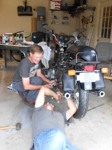

/7 owner David Heinlein gets the 'privilege' of working upside down. How else ya gonna learn?

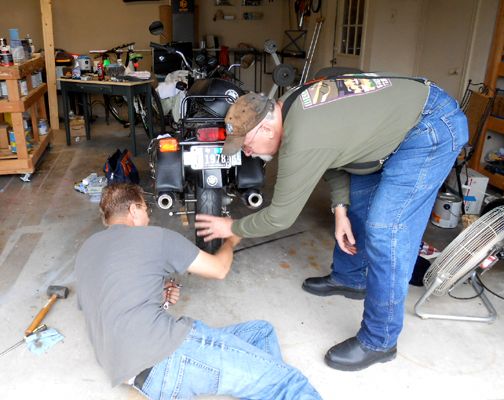

Mike "Bengt" Crenshaw explaining the finer points of bearing preload.

I suspect that the tool roll on the front mudguard is going to do a mischief to the headlight alignment. but aside from that - lovely for a naked bike.
Re: Filter critter
« Reply #2 on: August 01, 2014, 09:02:35 AM »
Gently suggesting that the fork-mounted tool roll be donated to a homeless H-D rider. There are also gin-u-wine BMW hard bags in the garage.
Not a concho and latigo fan for my scoots. ::)
