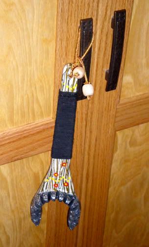

« Reply #5 on: July 07, 2014, 10:22:42 PM »
My genuine, authentic reproduction of a "Lost Tribe of The Fugawee" war club has its teeth well rounded over from bashing the heads of many Comancheros. Makes a perfect Airhead exhaust butterfly nut remover. Must be cast from the soft silver conchos favored by the Western invaders as it has never left a bloody mark on my nuts.
Acquired for $20.00 from a California emporium displaying and selling vintage Motorrad and native American farkles.
