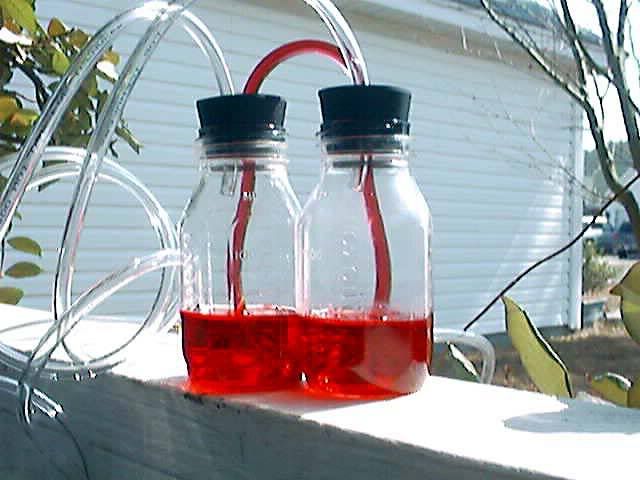

« Reply #10 on: May 15, 2008, 08:17:00 PM »
I like using the 5$ manometer as much as I like using an electronic tuner for my guitars. I just don't have the ear for either without help. Heres a variation on the $5 balancer that looks interesting,
Re: Carb balancing?
« Reply #11 on: May 15, 2008, 08:23:15 PM »
Well, first time I've seen that mutation...
« Last Edit: May 15, 2008, 08:23:36 PM by admin »
It would be good filled with red wine!!!at least there would be an excuse for sucking it out afterwards!!!(but don't go for a test ride till the next day!)very interesting idea,cheers(hick!!)J.
