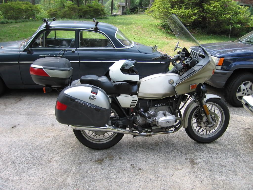

If you would like the R65LT version may I suggest this...
Riding in comfort year round!   8-)

Bill, what the heck kind of side bags are those?  Did you have to shorten your turn signal stem to fit them?  How fast can you go with all that stuff?
I have a Samsonite rear trunk for my bike but took it off because I don't use it.  It's too big, anyway.
I wonder if my aluminum parts are oxidizing under their protective (?) coating of road slime and mud.  I need mud flaps.
<snip>
Hi Ed.  The side bags are Givi E41's. The Top gase is a Givi E52 with brakelights.  I had to move the the turnsignal stalk aft to the bottom mounting plate of the top case.  I just removed the whole stalk and base plate from under the tail light and extended the wires from.  Also the mufflers had tomove down an inch to keep them from melting the E41's.   I placed SAE quick disconnects in the wiring for when I dissassemble the whole thing for doing the spline lube.  The tail luggage rack is re-inforced with two peices of steep tubing.  Most of the weld joints have been re-inforced with either steel welds or bronze.  The tail rack is now quite strong.  I have had a 3 gallon boat aux tank strapped to the top of the top case!!
Max speed is 75mph.  I commute at 60 mph and usually keep the speed at or below 70 on the road to somewhere like camping.
