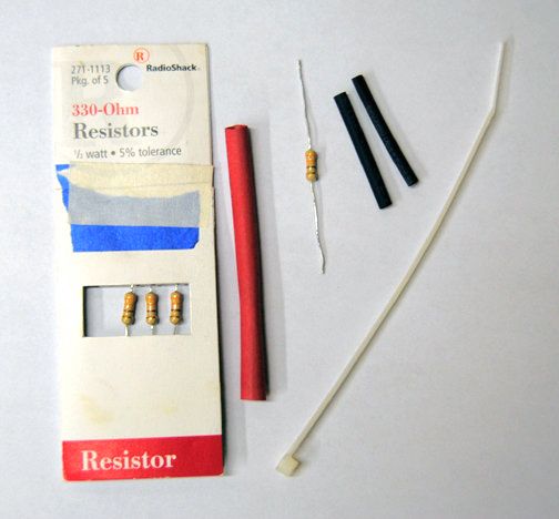

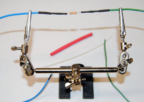

The GEN lamp is a 12v-3w filament-style bulb. The resistance created by the bulb's filament is used as an exciter to wake up the alternator and have it begin charging. Should the bulb burn out, there will be no charging at all. The back-up circuit is nothing more than a 330-ohm resistor wired parallel to the GEN lamp, providing the same resistance as the bulb. LED bulbs will not work as a primary GEN lamp.
Here is what I used to build the resistor circuit. Note the blue and green wires are the same color as utilized by the GEN lamp circuit.
Solder the resistor to the wire leads. Add short pieces of shrink tubing over the soldered joints. Finally, cut a section of zip tie and use it as a stiffener to protect the resistor. Another bit of shrink tubing covers all.
