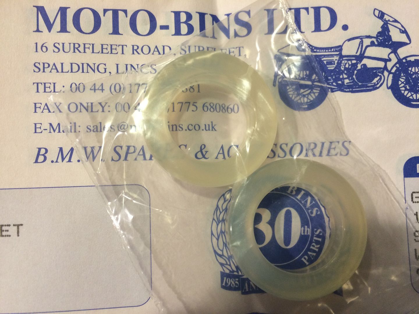

Motobins parts arrived

« Reply #23 on: September 05, 2015, 08:34:07 AM »
I've also put the Motobin's stop rings in, just like the ones above.  They feel about the same hardness as the BMW sourced red rings as far as I recall.  Had to re use a bent fork tube (out by 2mm), damn funds are tight, so they may not last well either.  But will use Castrol fork oil this time, eh Tony.
