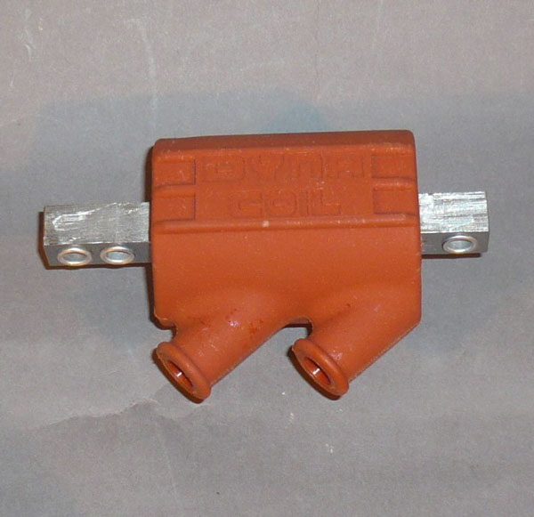

This is what everyone is using

Argh!  The dreaded Bosch Crack-O-Matic ignition coil. Dollars to Donuts, that's your problemo. Especially troublesome during damp weather.
It would also not hurt to replace the coil's plug leads and the sparkle plug caps.

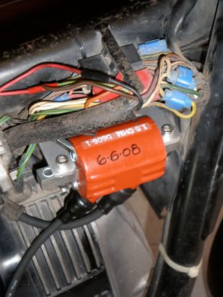

My old coil off the '81 R65. Note the circular pattern of cracks on the end of the coil. Stopped the bike deader'n a wedge.
Replace it with the easy plug n' play Dyna Brown coil. Yes, it looks orange to me, too. When space permits, I usually put the install date on replacement parts. Looking at that date on the coil... Woah! Time flys.
