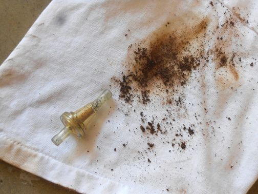

Just this weekend, I had removed the fuel tank from the '81 R65 to do the drain, flush n' dry service. Really pleased to see the OEM tank liner in fine fettle.
   A very small amount of water in the non-petcock, right side of the tank and a little bit of debris was drained out. Didn't take long for the remaining moisture to be evaporated from the black fuel tank as it sat on the deck in 103 degree Texas heat.

Tank and fuel filter debris accumulated over 2-3 years.
No loose tank liner material found.

It is a good thing the petcock screens work as well as they do, even with an added in line filter.
For northern bikes, I try to drain them completely and rinse them out thoroughly every year or two.   We get plenty more moisture up here and the likelihood of it working its evil magic during the long winter layovers is even worse.

My Karcoma petcock may have been 'modified' sometime during it's life as there are no screens over the straws. The straws are of some sorta plastic.

I believe that Hans Lowe at BMW Hucky has the screens for the petcocks.
Re: LED turn signals
« Reply #5 on: August 11, 2014, 06:08:28 PM »
There were no screens over the intake tubes on the bikes with the Germa fuel taps .
My '81 never had them and I'm the only owner .
« Last Edit: August 11, 2014, 06:09:28 PM by Bob_Roller »
« Reply #6 on: August 12, 2014, 08:03:11 AM »
The Germa has a small screen in the bottom of the fuel tap with the hose barb.  Still helps keep stuff from the carbs, but the crud can build up inside the passageways of the tap and cause problems, and the small screen can clog up much more quickly by the looks of things.
The 7 hole disc of the Germa is also a little tougher to source for a rebuild, too.  Mine's become bench art and a Karcoma now adorns the tank.
